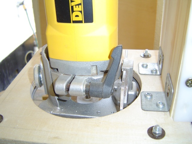

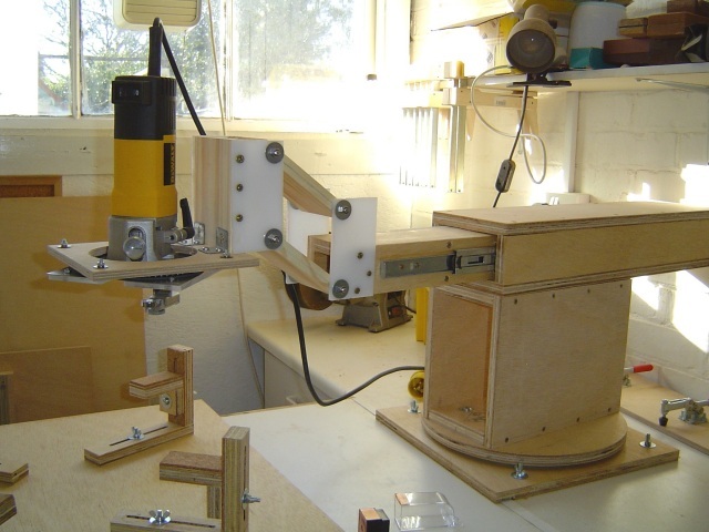

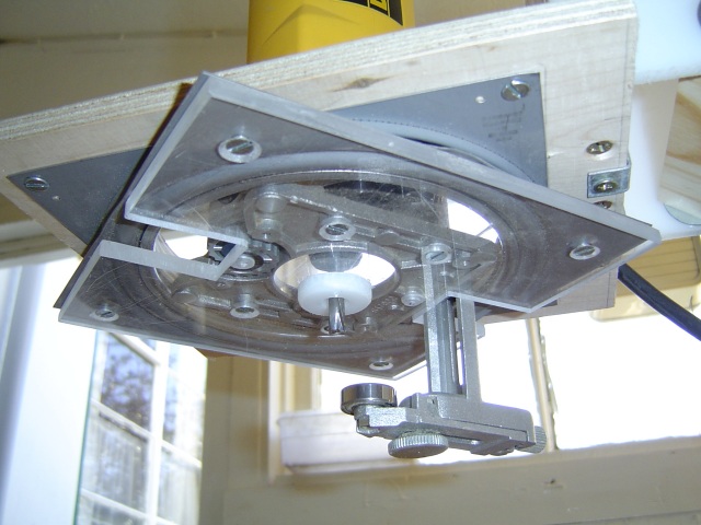

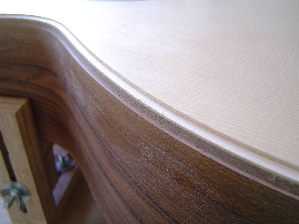

Yes, W/F rig is the way to go. I don't like the bearing to be mounted on the cutter though, prefering to use on mounted on the trimmer (had a bearing jam on a cutter and burn the side badly). So Dave White designed a modification to the W/F rig incorporating a second lazy susan bearing that the trimmer is mounted on so that the trimmer itself can revolve to keep the bearing perpendicular to the side of the guitar. This rig gives me the best binding ledges I have ever had. The advantage is that you can use a 1/4" downcut spiral bit for clean cutting.

I'm in the Williams/Fleischman camp as well. I've fiddled with an original LMI jig (used it once), and a homeade jig that was sort of a combination of a Williams trapezoid, and an Ribbecke jig, but used a follower guide and both of them worked with a little finessing. But to be honest, it wasn't the best, and it wasn't simple.
The last bindings I installed were done with the W/F jig, identical to what Hesh showed above and honestly, if the bindings are bent to shape, you can glue them in in about 20 minutes.

Wow, Colin. Very neat modification.    Looks to be very much the best of both styles. Is that an easy mod or was there a great deal of fabrication?

colin, i think david's modification to allow the use of a router mounted as opposed to the bit mounted bearing is rather clever. i think i have seen some mention of it before but your photo is the first i've seen of its implementation.

Donovan, the modification is all Dave White's idea it is exceptionally elegant in conception and easy to make, (I did it!), look here for the details on Dave's website
Dave's trimmer base modification

Colin, Very nice looking jig ya got there. I assume you have to keep it aligned with the bearing and router bit 90° to the side as you move around. Is that a problem at all or just something to be learned, or am I missing something?

Keeping it at 90 degrees to the side is very easy - no big deal. Dialling in the different widths with the router depth setting takes some time but it is very versatile and you can use one router bit for all of your binding and purfling cuts and can use any "non standard" depths as well. Changing router bits takes time too and having to have one for every depth of cut you need to make can be expensive.

John, it's important of course to have everything set up square as with any format of the W/F jig. And of course ensure that the guitar body sides are perpendicular to the base. After that it's simple, just ensure contact for bearing and doughnut and job done. I always test cut with a test block at 3 or 4 points around the guitar's position.
I absolutely love this jig, I couldn't use a W/F jig until Dave came up with this modification, I will be forever in his debt (not literally Dave, just metaphorically!)
